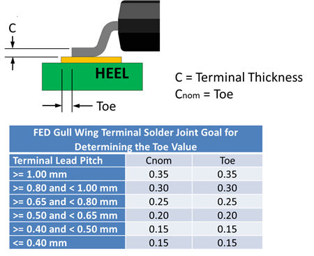

Here is Rainer Taube’s mathematical model for land pattern calculation for two popular standard component packages. This closely resembles guidelines in the IPC J-STD-001 Standard. Although this land pattern solution also still creates duplication due to various terminal lead heights, a lot is simplified by utilizing the average terminal lead height for each component chip size package and each pin pitch for gullwing packages. The solder joint goals for Toe, Heel and Side can be hard coded. This concept will minimize duplication of footprints in CAD libraries.

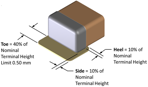

EXAMPLE 1 - Rectangular End Cap (Chip) Leads:

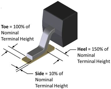

EXAMPLE 2 - Gullwing Leads:
PCB Libraries, Inc. added the Nominal Calculation Mode to Footprint Expert V25.02 as an alternative land pattern calculator in January 2025. Users can switch back and forth between IPC-7352 and the New Proportional Land Dimensioning Concept.
Create IPC or FED compliant footprints using package dimensions and your personal Options for pad stack rules, drafting outlines and solder joint goals.

In the early days of SMD soldering technology it was assumed that for a reliable solder connection the soldering surfaces on the PCB should be significantly larger than the component terminals themselves. This is still reflected today in the applicable standards of IPC-7351B and IEC 61191-2. Although repeatedly revised and adopted to the ever-finer structures, the currently defined specifications and calculation methods for creating the soldering surfaces fit less and less to the constantly changing component terminals, especially the smaller they become, above all because constant absolute values are specified for the protrusions.
For modern reflow soldering processes, these are outdated rules and measures, as practice has shown. Soldering surfaces that protrude too far generate lateral tensile forces, which in extreme cases can lead to the dreaded tombstoning (tombstone effect) in assemblies with chip components, for example, or solder bridges in multi terminal components. So, too much solder and area can have negative effects during the soldering process. In addition, any unnecessary use of space is a considerable disadvantage, especially for the densely populated assemblies with a high concentration density.
The constantly expanding, almost incalculable variety of component terminal shapes, sizes and grid dimensions requires an adaptive dimensioning of the corresponding soldering surfaces for optimum solder joints.
This is where the New Proportional Land Dimensioning Concept comes in. It enables the calculation of the suitable land on the circuit board in proportion to the size of the component terminal, considering the physical properties of the soldering process: wetting, capillary action and force transmission. In their interaction, however, they cause the solder meniscus and coverings specified in the applicable standards under reliability aspects without unnecessarily or negatively affecting too large pad areas.
The starting point for the proportional concept is the requirements at the solder joints as described in J-STD-001 and IEC 61191–2 on the one hand and a new specified simplified classification of components, according to their terminal types on the other.
While the IEC land pattern standards as well as the IPC–7351B differentiate the components according to package families, the proportional concept is based on a two-stage classification according to terminal types.
