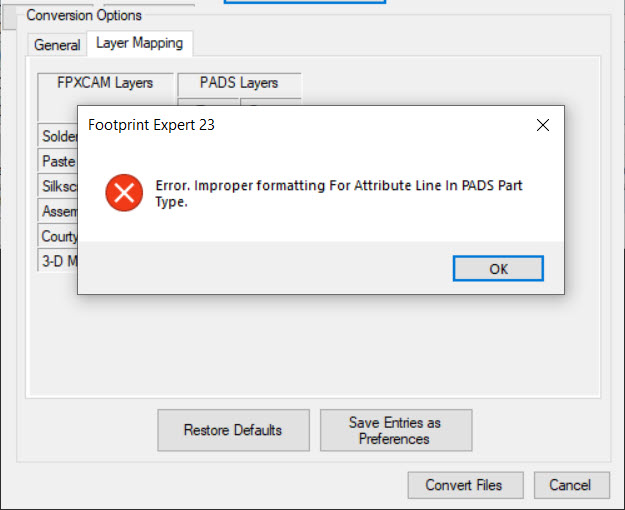

Looking to convert some Mentor - .c .p and .d - files to Allegro - Cadence format? I tired the converter, but the following error came up. Thoughts?
Points: 6093
Post Options Post Options   Thanks (0) Thanks(0)   Quote Tom H Quote  Post ReplyReply Direct Link To This Post Posted: 27 Mar 2023 at 8:00am
This is easy.
The message indicates the .p (part type) file has attributes that need to be removed.
You can edit this file in Notepad text editor.
Remove all "Gates".
Also, you can send us the files and we'll edit them for you.

Post Options Post Options   Thanks (0) Thanks(0)   Quote this_is_Gil Quote  Post ReplyReply Direct Link To This Post Posted: 27 Mar 2023 at 9:45am
Tom,
Perhaps I'm doing it wrong.
See attached .zip file.uploads/15143/Pads.zip
Points: 6093
Post Options Post Options   Thanks (1) Thanks(1)   Quote Tom H Quote  Post ReplyReply Direct Link To This Post Posted: 27 Mar 2023 at 11:20am
Here is the PADS .p file. Delete the text in Red and change the 4 to 0 in Blue
