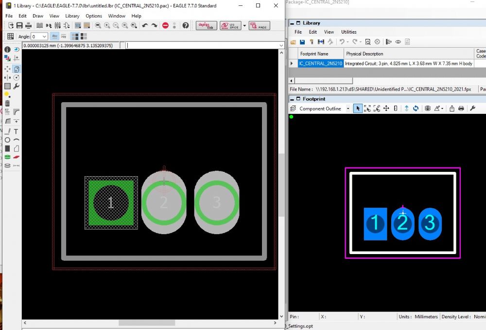

One more issue with rectangle pads becoming square in Eagle output files.
See the pin 1 in below Image.

Post Options Post Options   Thanks (0) Thanks(0)   Quote Jeff.M Quote  Post ReplyReply Direct Link To This Post Posted: 12 Jul 2023 at 3:29pm
Please provide an example of both an FPE translation to Eagle .scr file that is wrong and another version of that same file that has been edited correct this error.  That will allow us to compare and correct the discrepancy.

Post Options Post Options   Thanks (0) Thanks(0)   Quote Bharat_Verma Quote  Post ReplyReply Direct Link To This Post Posted: 13 Jul 2023 at 1:01am
Hi Jeff,
Please find attached zip file with FPX, LBR and SCR file.
This issue is not resolved in version 23.09.uploads/15710/Rectangle_pad_Version-9.zip

Post Options Post Options   Thanks (0) Thanks(0)   Quote Tom H Quote  Post ReplyReply Direct Link To This Post Posted: 16 Aug 2023 at 12:35pm
The latest V23.11 is released – www.pcblibraries.com/downloads
Download and install it.
This issue with the rectangular pad shape coming into Eagle as a square is fixed.
Thank you for reporting this issue.

Post Options Post Options   Thanks (0) Thanks(0)   Quote Jeff.M Quote  Post ReplyReply Direct Link To This Post Posted: 27 Sep 2023 at 8:47am
Eagle can't create a rectangle pad on a through hole.
