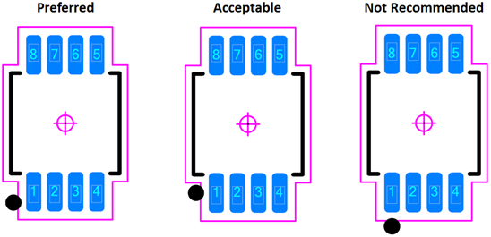

When using the calculator, PCB library doc strongly suggests that pin 1 indicator should be added by hand instead of the automatic way. I agree the automatic way is too dumb to be useful, it places the dot right in front of the pad where most likely a via will be placed and obliterate the dot. And also there is no way to move it.
But placing of the pin 1 dot by hand or adding a keepout have a big draw back too. All customizations will be wiped out if I change any dimensions and then click calculate.

The most important thing to remember about manually inserting polarity marking is to manually add them last.
However, you have a good point about putting the automatic silkscreen polarity marking to the left of pin 1 rather than at the end of pin 1.
We've heard this suggestion before.
As a result, by popular demand we're relocating the automatic Pin 1 marking to the left of Pin 1 for all footprints that have a Toe that is larger than the package width.
This will not affect any BTC (Bottom Terminal Components) like Grid Array's, DFNs, Pullback Lead PSON & PQFN, etc.
Thank you for your feedback.
This new feature will be in the next release of V2022.06 pre-release tomorrow or this weekend. We'll let you know.

Having the automatic polarity marker improved is a good thing. Hopefully some control will be given in the drafting tab of the part to offset the marker and to select among the 9 different shapes.

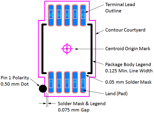

All silkscreen "clearance to pad" and "min/max dot size" are defined in Options.
At least we got this far after 6 years of customers asking for this.
And here are the elements of a Land Pattern:
