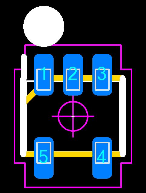

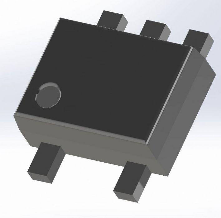

Hi, I create a transformer using transistor footprint SOFL since it used the same package.  But the XFMR has a slightly rotated pinout which I was able to change for the land pattern.  But when I generated the 3d Step file, the pin 1 marking didn't follow along and is incorrect in the step file.
Please see images below.

Post Options Post Options   Thanks (0) Thanks(0)   Quote JeffreyJ Quote  Post ReplyReply Direct Link To This Post Posted: 24 May 2017 at 5:03pm
I don't really need any of those.
What the issue is the pin 1 marking on the Step file output didn't follow the pin 1 on the part when it was mirrored and rotated inside of Library Expert (version 2017.13).
The footprint for xPCB cell was fine, but the STEP file output was incorrect.
This appears to be a bug.

Post Options Post Options   Thanks (0) Thanks(0)   Quote Tom H Quote  Post ReplyReply Direct Link To This Post Posted: 24 May 2017 at 5:08pm
OK, it's a STEP file bug and we will direct that to the correct programmer.

Post Options Post Options   Thanks (0) Thanks(0)   Quote Tom H Quote  Post ReplyReply Direct Link To This Post Posted: 25 May 2017 at 3:40pm
This issue is now fixed in V2017.14 pre-release - www.pcblibraries.com/downloads
