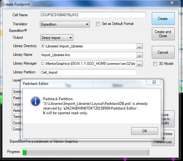

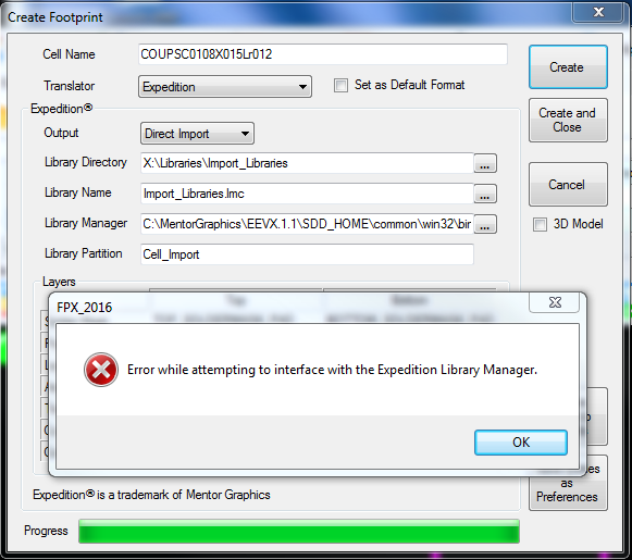

We had it working as well. The interface is now broken. My settings match the ones you sent.
The two programs are not interacting well. LE is closing and the MGC Library Manger remains open.
If I run with an administrator account an error message that my regular account has the PadstackDB.psk file reserved
Followed by an Error while attempting to interface with Expedition Library Manager.

Your first window shows the export connected to Expedition properly. It either does or it doesn't. That type of error you only see if a proper connection has been made and it has moved on to translation. This is the right way you should be running it. The second shows an inability to connect, which is the wrong way.
That said, Expedition itself has multitasking locks. If you open up a padstack on a partition in a library on one computer, it locks it to that user until it is closed. That prevents all other versions of Expedition from modifying the library and that partition out from under the person that has locked the access.
First, make sure nobody else is trying to access that library and that partition. Is e34234 an actual user on a network node starting with MN07? That's pointing you to who has that partition open(and locked from being written to).
Second, make sure you go to the task manager and close any Expedition programs(i.e. cell editor) that are currently open and may be sitting in memory, but not visible on the taskbar.
Then try the translation. The program has to be able to access an unlocked padstack partition in order to function properly.

Problem resolved. Somehow the padstack file got reserved and even though I was the person that was trying to export files it went unrecognized. Solution was to un-reserve file through the Mentor Library Manager.
