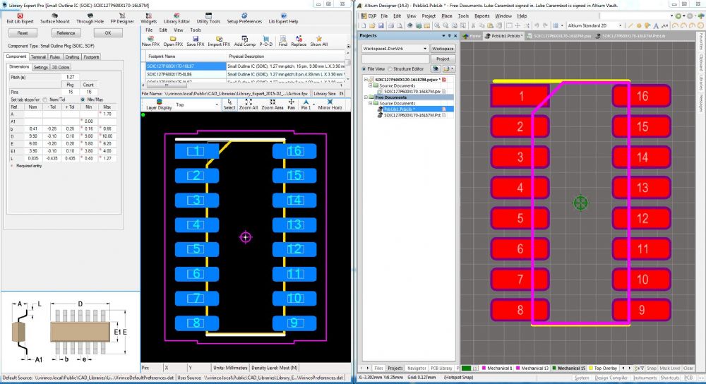

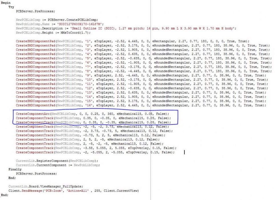

We have the PCB Libraries Expert Pro and just updated to version 2015.10. In this version, we have found that the Build Part function that generates an Altium script no longer generates the court yard outlines! The only thing we are seeing on the eMechanical15 layer is the centroid (cross hairs).
Any classifications or fixes will be appreciated.
Kind Regards,
Luke
Library Expert along Generated Footprint in Altium
The centroid is the only lines defined on eMechanical15

This issue has been fixed in the V2015.11 pre-release.
Please download and install V2015.11 pre-release here – www.pcblibraries.com/downloads
