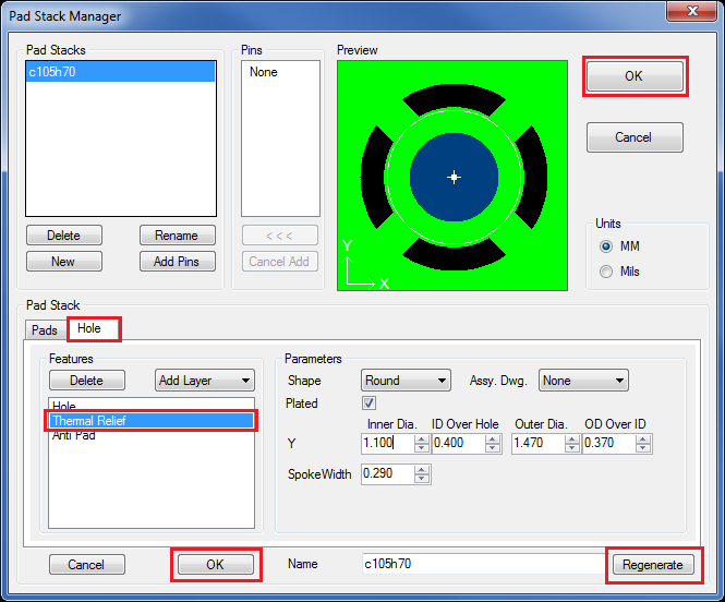

I'm trying to build a through-hole part using the FP Designer, and the pad stacks it creates do not have thermal reliefs.
Is there something special I have to do to accomplish this?
I just upgraded from 2013 to 2015, and 2013 did create the thermal pad stacks.
I must be missing something stupid.

In FP Designer you create pad stacks in the "Pad Stack Designer".
Then when you select "Done" the program opens the "Pad Stack Manager".
In the Pad Stack Manager, select the pad stack in the list and you can edit the Top, Inner and Bottom pad sizes and the Solder Mask size.
Select the "Hole" tab to edit the Thermal Relief and Anti-pad features.
Select the "OK" button on the bottom to regenerate the pad stack name.
Select the "OK" in the upper right corner to close the Pad Stack Manager.
