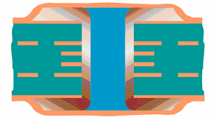

Hey  Tom, can You add a picture of "thermal relief on SMD when via is in pad" ????
a picture is better than words to understand the concept...
thanks.

The via-in-pad is when a SMT pad has a via in it and the GND / VCC connection is on the inner layer just like a normal through-hole component.
I always "Flood Over" every via in a PCB layout expect those that are via-in-pad will have a thermal relief.
The via-in-pad vias have to be specially marked on the fabrication drawing as they need to be plated, plugged, capped, surface finish and planerized flat so that you cannot tell if there is a hole or not.
