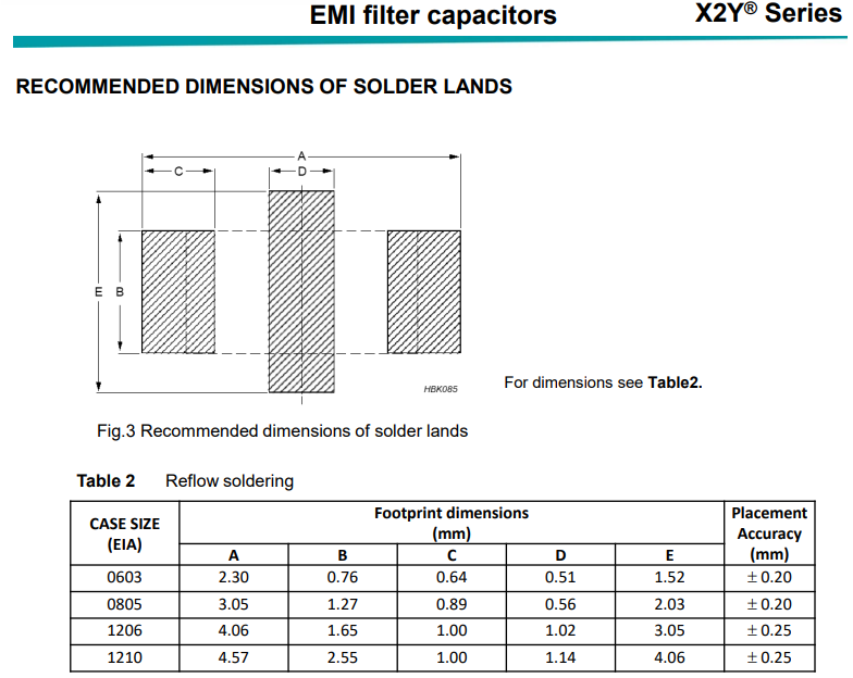

The part has 4-leads, yet the provided land pattern is three terminals (See Figure 3. Page 10, link below):
(Note, yes this is a different part that I originally stated, yet FP is comparable and it is published data)
Knowing that we'd end up connecting copper between the center two pins (as shown above), would we also extend the mask/paste completely across this center pin?
Does it make sense to have exposed copper/paste directly under the center of the ceramic body?
Other land patterns that I've seen, all had 4 distinct solder/paste areas (regardless of the copper shapes below)...

Post Options Post Options   Thanks (0) Thanks(0)   Quote Tom H Quote  Post ReplyReply Direct Link To This Post Posted: 13 Jan 2024 at 10:05am
You have Pin 1 (left), Pin 2 (right) and Pin 3 (Center).

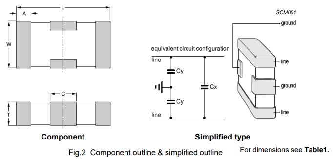

Post Options Post Options   Thanks (0) Thanks(0)   Quote Iain-Trakka Quote  Post ReplyReply Direct Link To This Post Posted: 13 Jan 2024 at 11:31am
Tom,
Looking at figure 2, there are 4 distinct pins:
Post Options Post Options   Thanks (0) Thanks(0)   Quote Tom H Quote  Post ReplyReply Direct Link To This Post Posted: 13 Jan 2024 at 11:38am
Makes no difference.
Use the mfr. recommended pattern.
