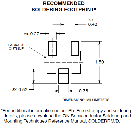

I am currently trying to calculate a SOTFL package (ON-Semi DTC114EM3). I was trying to adjust the "Side" fillet calculation for our very high shock application needs (beyond IPC Most) but the pad size does not change no matter the values put into this field.
The "Toe" and "Heel" pad sizes do change as expected when I input the values required.
I am using PCB Library version: 2013.14
As I dig deeper into this SOTFL package other issues are also arising. For example I have always kept my mask 1:1 with the pad. But in the case of this part the mask is being over-sized, even though the terminal setting is still at zero for both the X & Y fields.
I think in general this part type in the calculator has some issues

Check that the side isn't being trimmed to comply with your pad-to-pad clearance rule.
If that's not the problem please supply the values you're using so I can try to reproduce this condition.
Points: 6091
Post Options Post Options   Thanks (0) Thanks(0)   Quote Tom H Quote  Post ReplyReply Direct Link To This Post Posted: 04 Oct 2013 at 7:17am
Can you attach a URL link to the package dimension datasheet?
I would like to take a look at this.
Like Jeff mentioned, if your pad to pad spacing rule is set to a specific value the LE software will not override it until you select the "Footprint" tab and enter your own pad stack dimensions.

Here is the link to the datasheet:
http://www.onsemi.com/pub/Collateral/DTC114E-D.PDF
And the particular package is on sheet 11 (SOT-723). Not only is it a SOTFL, but pin 3 is not the same width as pins 1 & 2. ( I am seeing this more and more lately on SOT parts, not exactly sure why but my guess would be so that the suppliers are trying to compensate pin 3 to have more surface area so that the part will stay centered better on the pads and not try to pull pin 3 off the pad during the reflow soldering process. (i.e. surface tension pull of pads 1 & 2 are approx same as pin 3)
And as for the rules I was already assuming that it would not let me violate my user rule "Minimum Space Pad-to-Pad", so I even tool this value down to 0.05mm temporarily but no affect on the calculators outcome. It still will not change the pad width.
As for the value I am trying to change the "Side" fillet is per J-STD-001 where all the fillets for "Flat Leads (FL)" pins have to be 100% the pin thickness. So in this case the nominal value for dim "c" on the datasheet is 0.12mm. (I usually try to use the max value (all our products are extremely "high shock" so we always try to error on the side of worst case condition), but in the case of this tiny part this would defiantly cause a Pin-to-Pin violation)

The issue here is that there is no IPC-7351 standard component family for SOTFL with different size component leads. So you can't use the SOTFL component family calculator to enter all the correct dimensions because it doesn't exist.
That is why PCB Libraries, Inc. created Footprint Designer (FP Designer) for these non-standard unique component packages that come with mfr. recommended solder patterns. And if you did not want to use the mfr. recommended pattern you could create your own pad stack sizes.
This SOT-723 part should be built once in FP Designer and contributed to PCB Libraries so that no one has to build it again. Eliminate duplication of effort. Then you could take the existing footprint and modify the pad stack and auto-generate a new "custom" footprint in seconds.
