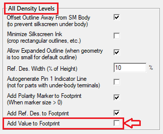

Go to 'Tools > Options > Drafting > Silkscreen > All Density Levels > Add Value to Footprint > Uncheck it'

I had already tried that but I didn´t work. Or I thought it didn´t work.
Now I have looked more carful at the output and I understand what is happening.
The generated file does indeed not include Value. but when KiCad opens the footprint and Value is missing then it adds it because Value (and Reference) must exist.
What need to be done if Value is disabled, is to set Value to hidden in the output file. The same goes for Reference.
