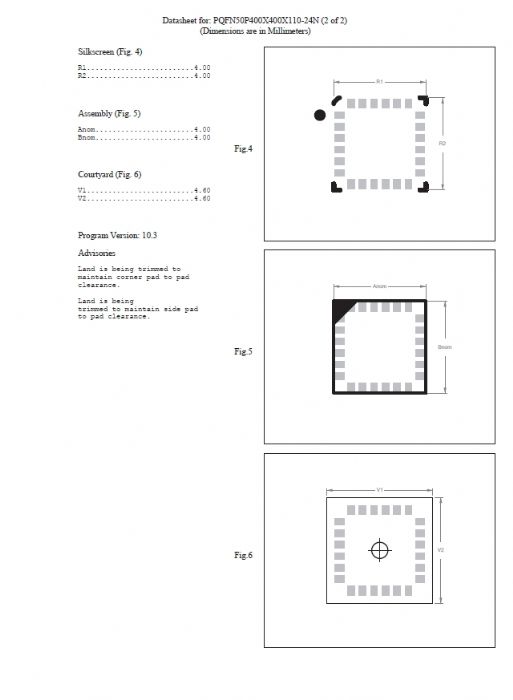

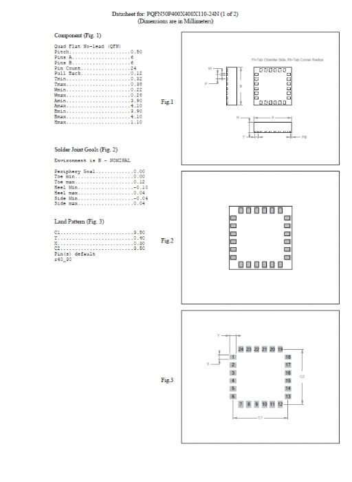

is it possible, to get settable printing options for output a detailed documentation of the current displayed part and options?
for e.g.:
- Settings
- Terminal --> Settings, Environment, ...
- Rules
- Drafting
- Assembly, Courtyard, ..
- Program Version, Warnings
- Current name of configuration
So it can completely reproduced (*.pdf) with which configuration the part was built, or if the current settings are changed before build.
Because i have seen, that if the component settings were changed an the part was saved in the library, than the changed settings are not included in the library and the builded part was not repeatable.
Here was an example made with LP Wizard:
