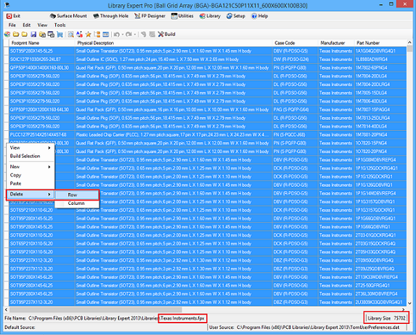

  1. Can't delete multiple rows with right click when many are selected.  Have to use edit  > delete
In the Library Editor, if you select the Gray Rectangle Box to the left of the footprint name it will highlight the Row. If you click and drag or CTRL Click or Click scroll and Shift Click on the Gray Boxes you can select multiple Rows.
Then you can Right Mouse Button on any of the selected Gray Boxes and select "Delete > Row".

In the past 10 years since we've been creating IPC Footprint Calculators and Library Management documentation tools, I've never heard of anyone deleting thousands or even hundreds of Rows from an FPX file.
Normally, you would select the parts you want to keep and RMB select Copy and open a new Library and RMB Paste / File Save As / New Name . FPX
I opened the Texas Instruments FPX file with 75,702 parts and I selected all the Rows and RMB delete and it took 8 minutes. I tried the same thing with SM.fpx with 3,000 parts and it took 10 seconds.
