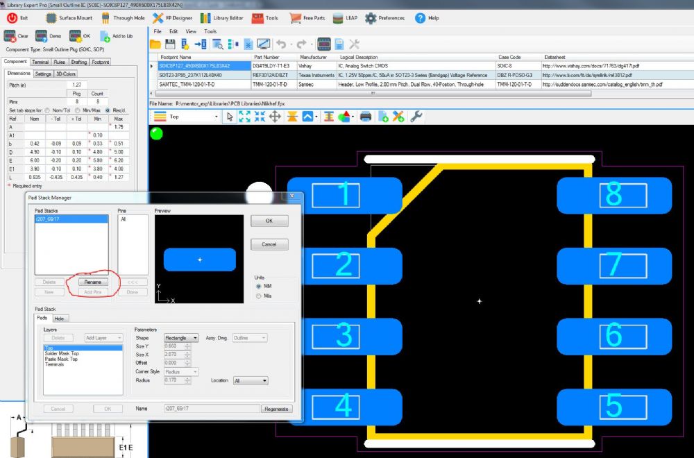

I want to rename the padstack, so that it complies with the padstacks we already have in our library.
c45 --> SM Round 0.45
This is changed by the software to "SM Round 0_45"
Is there a restricting on the padstack naming?

Post Options Post Options   Thanks (0) Thanks(0)   Quote magnus.lictor Quote  Post ReplyReply Direct Link To This Post Posted: 11 Apr 2017 at 11:57pm
Are you sure?  The button is there.

Post Options Post Options   Thanks (0) Thanks(0)   Quote magnus.lictor Quote  Post ReplyReply Direct Link To This Post Posted: 12 Apr 2017 at 12:13am
And I can really change the name,  only the .  is changed to a _
