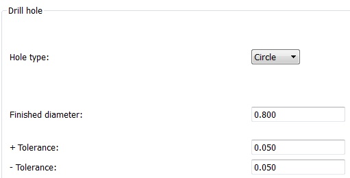

We have a Fabrication Tolerance setting. Is this usable as the allegro padstack tolerance setting? Or do you need something more? Are you looking for each padstack to have a tolerance, or will a global tolerance that you set(i.e. from a cell in the grid) work?

Default fabrication tolerance seems to be about 0.05 mm.
I have some pad stacks at that setting, but my general standard is a +/- tolerance of 0.08 mm.
In Allegro, each pad stack has a positive and negative tolerance (they can even be different).
A global drill tolerance single value entry that populates the positive and negative drill tolerances each with that same number would work for about 90% of the pad stacks I'm creating, then if something else is needed, I can manually change it.

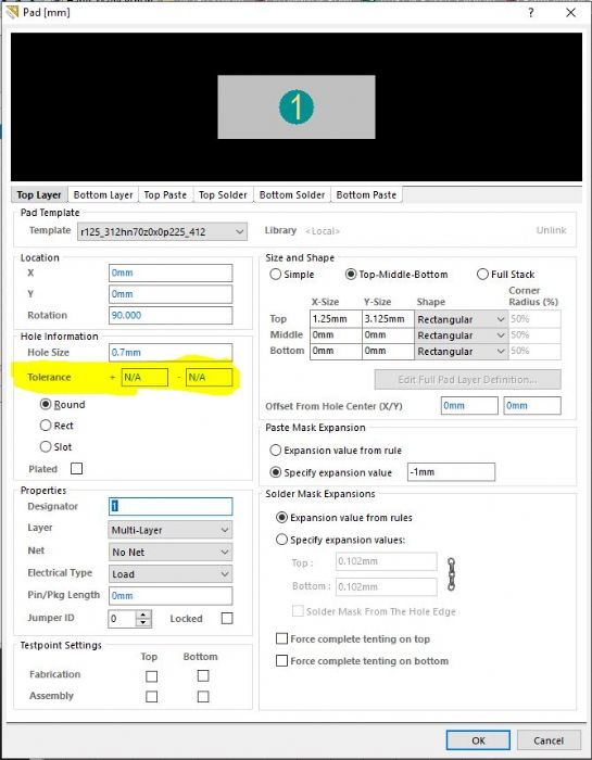

Altium has supported drill tolerances on holes since version 17.1 or possibly earlier. I also would appreciate this feature.
ransonjd View Drop Down
Joined: 15 Nov 2016
Points: 144
Post Options Post Options   Thanks (0) Thanks(0)   Quote ransonjd Quote  Post ReplyReply Direct Link To This Post Posted: 27 Jun 2019 at 7:34am
Altium doesn't require a tolerance, so I leave it unset and specify a default tolerance in my fabrication drawings for most holes. I would like if this could remain an option for Altium.
