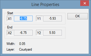

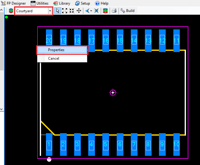

In the Calculator window, Right Mouse Button click and there are options for Pads, Shapes, Lines, Text, etc. select Lines or Shapes.
Then drop down the Layer you want to select. In this case it would be "Courtyard".
Then Left Mouse Button and select the courtyard and Right Mouse Button select "Properties".
You can do this with any component family.
