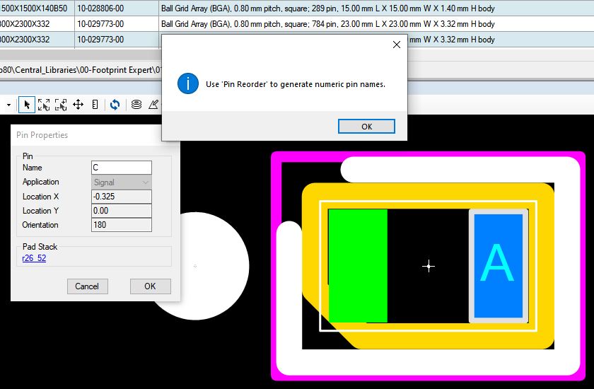

Sorry, I don't get it to work the way you described it.
If I try change Alpha pin to Numeric in Pin Properties, I got this message (Use 'Pin Reorder' to generate numeric pin names), but can't find it anywhere. (See image below)
Also for exemple, with your method, I can change a 'C' for a 'K', but this information is not saved to the FPX file.
I don't understand why I have some diodes in my FPX with alpha pin and others with numeric pin.
I'm lost...
Thank you!
