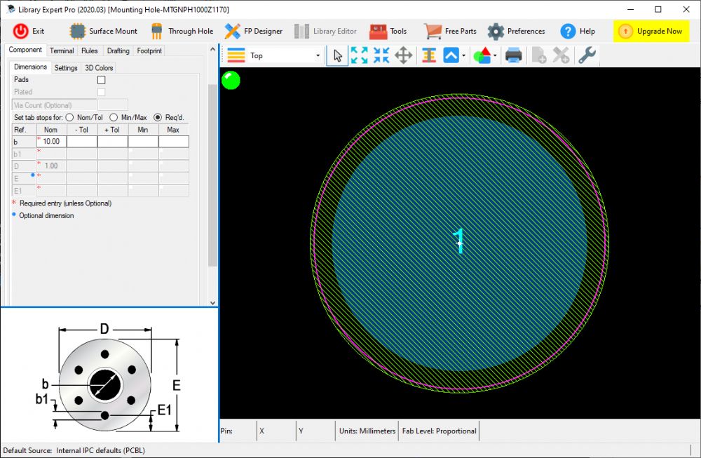

I just noticed that sometimes in Mounting Hole a Courtyard is located into a keepout area. Which clearance is preferred in this situation?

Note: the keepout overrules the courtyard.
