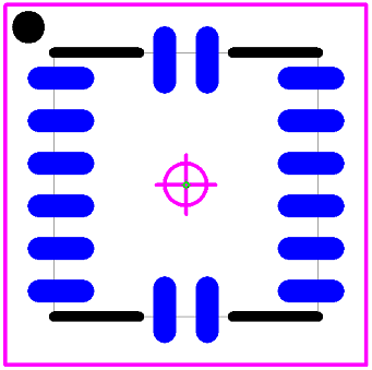

Using the CAD tool editor I would make my part look like this -
The current PCB Footprint Editor is a basic "Template" tool for "Standard Component Packages".
This QFN is just outside the "Standard" category. So until the FPE program introduces interactive editing you'll have to spend a couple minutes adding some custom silkscreen lines using your CAD tool library editor.
