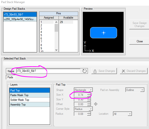

Another slight issue I have found with the way values are rounded (using the Decimal Place Accuracy option) is in the naming of the padstacks.
If we use the demo QFN (with thermal tab) with a Decimal Place Accuracy of min:2; max:2, the name given to the padstack is r73_30m93_50r7. But the padstack is actually a 0.74mmx0.30mm rectangle (not 0.73mmx0.30mm).
I think this is due to the fact that, when Decimal Place Accuracy is set to min:2, max:3, the actual length of the padstacks is 0.737mm. That gives the r73_30m93_50r7 naming. But that naming isn't updated when using min:2, max:2 accuracy. I rebooted the software but the issue is still there.
