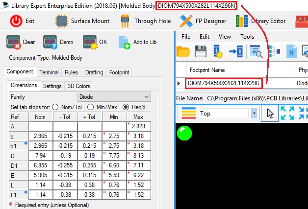

When I create new footprint in Library Expert Enterprise I can see the "N" for Nominal in the name.
However, when I add the footprint to my FPX library the N is no longer shown. See 2nd pic below.
Is there a way to fix this?

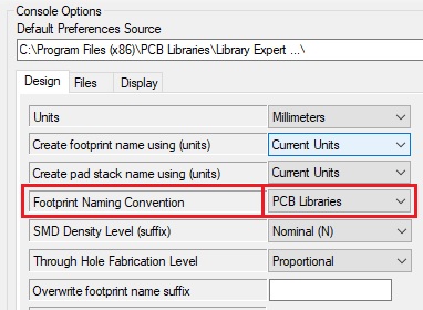

Also, and this may be related to my issue, what is the difference between the footprint naming conventions of IPC-7351B vs PCB Libraries? I'm currently using PCB Libraries' naming conventions.

The FPX file only contains Component Dimensions. You can't assign a Density Level to Component Dimensions.
Preferences has all the other things (Orientation, Pad Shape, Drafting Outlines, Solder Joint Goals, Rules) that make a land pattern footprint including the Density Level
The Footprint Name is neutral until you generate the PCB library part by combining the Component Dimensions with the Preferences.

The PCB Libraries naming convention is IPC-7351C, but IPC has no scheduled release date for the 7351C.
IPC was getting notified by many of our customers asking when 7351C will be released.
As a consequence, IPC asked us to remove all occurrences of 7351C on our website and in our software because 7351C may not be released for another year or more and it may change (update) again. But we can't wait because there are too many issues with the IPC-7351B naming convention.
