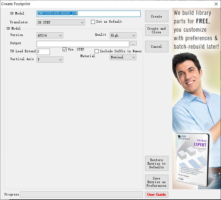

Hello everyone,
I have used Library Expert Pro(2019.07) to create Chip Inductor footprint but after i click the "Add Footprint to CAD Library"button,it shows this:
I cann't export PCB Footprint to CAD!

Go to "Help", select "Installed Options", and select your CAD format.

I know ,thank you very much!
