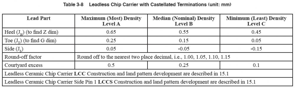

There were no solder joint goal changes between IPC-7351B and IPC-7351C.
Here is the LCC solder joint goal chart that does not match any of the values you posted -

Thanks for reply on this. On closer examination it appears we were using the Oscillator option of the Mentor LP Wizard rather than LCC option. We have now change to the LCC option and the values now align.
