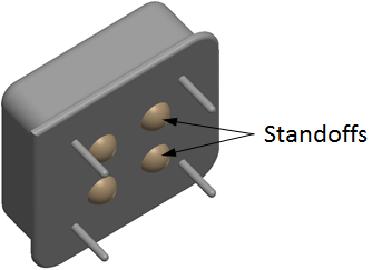

IPC-J-STD-001 identifies Hole Obstruction as “Parts and components shall be mounted such that they do not obstruct solder flow onto the solder destination side lands (pads) of plated through holes (PTH’s) required to be soldered”.
Example of Hole Obstruction:
This issue pertains to through-hole terminals that are under the component package where the bottom of the package sits directly on the PCB surface and can be resolved by simply lifting the component package slightly off to PCB surface. IPC-J-STD-001 states minimal acceptable conditions for supported holes for through-hole terminals are Acceptable for Class 1, Process Indicator for Class 2 (means the assembly process can be improved) and a Defect for Class 3.
The solder for PTH parts should reveal “Visible Wetting” on the top side of the PCB.
To avoid Hole Obstruction, component manufacturers are forming the package body to lift it off the PCB allowing the Air in the hole to be pushed out and form an adequate solder joint.
4-pin PTH Oscillator with bottom side bumps:
LED with Lead Stops to prevent the component body from touching the PCB:
Radial Capacitor with Kinked Leads to be able to inspect “Visible Wetting”:
