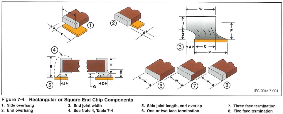

As for the RC0402 I've though of it once, however PCB patterns cap are a bit wider than resistors because of sides that can be soldered which is not the case for resistors and in some case this extra surface could cause placement problem on crowded PCB.
Of course you can use the resistor pattern for both of them but then why cap have component end covered on all side and not the resistor?
Could somebody enlight us on this? Question
Points: 6090
Post Options Post Options   Thanks (0) Thanks(0)   Quote Tom H Quote  Post ReplyReply Direct Link To This Post Posted: 23 Jan 2017 at 12:46pm
You need separate Chip land patterns for Capacitors and Resistors.
Capacitors should have a side fillet and Resistors do not.
However, IPC says that the same pattern can be used for both because the Side Fillet is not required per IPC-J-STD-001.
They do mention in Note 3 that there should be "Visible Wetting" but that's not possible with chips that do not have a terminal lead wraparound.
