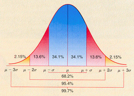

For example if a P&P machine has an accuracy of +/-50um (3 sigma), assuming that the component placement is a normal distribution
I think that it means that:
  • the 68.2% of the components will be placed with a tolerance +/- 17.05 um
  • the 95.4% of the components will be placed with a tolerance +/- 23.85 um
  • the 99.7% of the components will be placed with a tolerance +/- 24.925 um
So the placement tolerance of +/- 0.025 mm is not a value far from the reality.

Today's pick & place machines have a tolerance of +/- 0.01 mm.
How old is the image that you posted?
The V23 footprint expert allows the user to edit that assembly tolerance to match the age of the machines you use.
However, the pad stack calculations are so subtle that the difference between 0.025 assembly tolerance and 0.00 is too small to be concerned.
