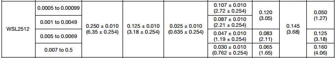

I have noticed a few cases of part dimensions being truncated instead of correctly rounded up or down. I'm not so worried about a -0.01mm rounding error on Length or Width dimensions, but we are very strict about package Max Height.
I'm not sure if this is a bug, or behavior specified by the IPC standard, but it seems obvious that Max Height should never be rounded down.
For example, Vishay resistor WSL2512R0100DEA (Datasheet: http://www.mouser.com/ds/2/427/wsl-101914.pdf).
According to the datasheet, the max height for the 2512 package is 0.889mm. This should be rounded to 0.89mm. Instead, Library Expert rounds it down to 0.88mm in the footprint name (RESC710X420X88L157).
The actual height of the exported footprint in OrCAD is 0.89mm, so it's fine there.

Library Expert Pro rounds to 2 decimal places (3 if necessary) for millimeters.
We opened the datasheet and the dimensions for a 2512 don’t have a reference height of 0.889 mm.
When built using these dimensions we don’t see any rounding other as described above.

0.635 + 0.254 = 0.889 Max height.
Instead of rounding the height in the footprint name, Library Expert seems to floor() it.
