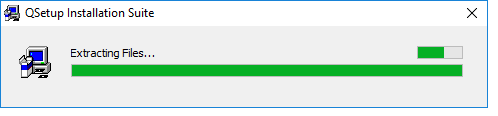

I have already downloaded several files on the site and none of them have gone through this extraction part.
Is there any extra procedure?
I tried installing the PRO and POD versions, but all to no avail.

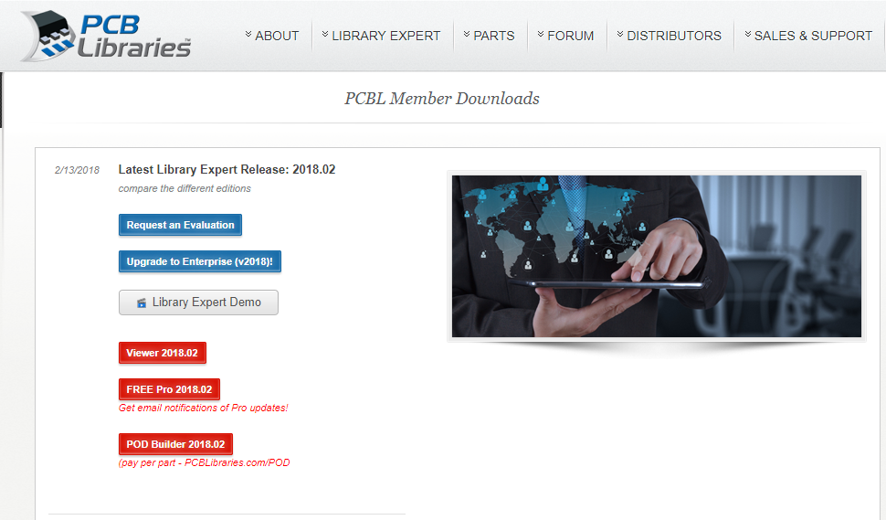

The V2018 POD Builder must be registered with us because it's a full function program with all features turned on except the ability to create new parts.
POD Builder is used exclusively for users who purchase POD credits to download FPX files from "Parts on Demand" (POD).
POD Builder is registered to a specific computer IP address to access the 1 million parts on POD.
The V2018 Library Expert Pro was "Lite" last year and we added more features to upgrade the product name to Pro.
LE Pro is a free download and does not require a license or registration and can be installed on any computer. You can also purchase POD credits for the new LE Pro to save library creation time and money.
Uninstall everything and delete all folders and try to just install LE Pro.

I downloaded all the "free" I found, also disabled the antivirus and the firewall to download, even so, as soon as the extraction part (of the image of the post), it closes and does not open anything else to give sequence installation. Until the "viewer" version does not install
I use windows 10
If it is possible to pass the free version link, for me to try again, thank you.

Post Options Post Options   Thanks (0) Thanks(0)   Quote ajr_almir Quote  Post ReplyReply Direct Link To This Post Posted: 28 Feb 2018 at 12:49pm
I was able to use "virtual machine" with W7, installed it successfully. Thank you
