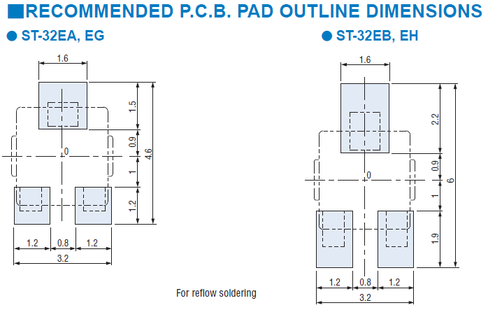

Which surface mount part do I use best for a trimmer from Copal? I did not find a part that fits.
Datasheet is uploads/10602/Copal_Trimmer_ST32.pdf

You would use FP Designer and it will take you about 5 minutes from start to finish.

As I understood does the FP designer not calculate the best pad sizes and positions.
Post Options Post Options   Thanks (0) Thanks(0)   Quote Tom H Quote  Post ReplyReply Direct Link To This Post Posted: 09 Dec 2014 at 8:45am
The component manufacturer provided great pad stacks and positions for these 3-pin parts.
The Footprint Name would be - COPAL_ST32

Sorry but I can't find this footprint COPAL_ST32.
Post Options Post Options   Thanks (0) Thanks(0)   Quote Tom H Quote  Post ReplyReply Direct Link To This Post Posted: 09 Dec 2014 at 12:04pm
This is in the datasheet -
