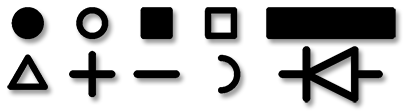

I forgot to mention that there is a feature for manually adding Polarity Marking using 8 different shapes and you determine the Size, Location, Shape, Filled or not Filled, Layer, etc. and it's saved to FPX file.
If I was creating my custom library, I would use the manual mode so that small parts have small polarity markers and Large parts have Large Polarity Marking.
I like to be in control and it only takes a minute to add a custom polarity marker exactly where you want it.
Interesting. Would this mean I would pull the footprint into the Footprint Designer and manipulate the indicator from there?
Points: 6093
Post Options Post Options   Thanks (0) Thanks(0)   Quote Tom H Quote  Post ReplyReply Direct Link To This Post Posted: 19 Dec 2018 at 1:33pm
No, you can manually place these Polarity Markings in any Calculator. No need for FP Designer.
Watch this short video -
