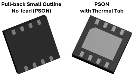

Pull-back Small Outline No-lead (PSON)
Pull-back Small Outline No-lead (PSON): A highly specialized variant of the standard Small Outline No-lead (SON) footprint where the metallized terminal pads are deliberately recessed (pulled back) away from the outer edges of the plastic mold body. Because the electrical contacts do not reach the side walls of the IC, the molded plastic encapsulation completely encloses the outer perimeter. This structural design maximizes board routing space, reduces the risk of accidental electrical shorting, and eliminates visible external solder fillets. Component manufacturers frequently label this package family as PSON or Plastic Small Outline No-lead.
The "Pull-back" Mechanism Explained: In a standard SON or DFN/QFN package, the copper lead-frame terminal pads are cut during the singulation process, leaving exposed raw copper edges on the sides of the chip. In contrast, a PSON package pulls the terminal ends inward.
Key Mechanical & Technical Specifications
  • Recess Distance (Pull-back): Terminal pads are typically shifted inward by 0.075 mm to 0.15 mm from the nominal package outline.
  • Lead Pitch: Maintained at standard fine-pitch intervals of 0.50 mm or 0.65 mm.
  • Low Profile: Height dimensions mirror thin variants, frequently standardizing around 0.75 mm to 0.85 mm.
  • Thermal Interface: Incorporates a large central exposed die pad to ensure low thermal resistance.
Architectural Benefits & Engineering Trade-offs
  • Creepage and Clearance Advantages: By burying the conductive terminal pads underneath the insulating plastic body, PSON packages drastically improve creepage and clearance distances between adjacent traces on high-density layouts. This makes them popular for compact power management ICs (PMICs) and low-voltage switching regulators.
  • Reduced Perimeter Footprint: Because the pads do not extend to the edge, PCB designers can bring peripheral components, ground fills, or trace routing closer to the IC boundary without violating safety clearances.
  • Inspection Challenges (The Solder Fillet Trade-off): During surface mount technology (SMT) reflow, the hidden pads prevent the formation of an external side solder fillet. Because there is no visible side wetting, Automatic Optical Inspection (AOI) systems cannot verify the joint integrity by looking at the perimeter. Electronics manufacturers must rely on Automated X-Ray Inspection (AXI) to guarantee that the hidden pads are properly wetted.
PCB Design & Stencil Requirements: Creating a reliable footprint configuration for a PSON package requires specific modifications to your IPC-compliant CAD library:
  • Pad Inward Extension: Unlike standard SON packages where pads extend outward to form a toe fillet, PSON footprints require the copper pads to expand slightly inward toward the center thermal pad to guarantee sufficient contact area.
  • Solder Mask Webbing: Due to the pulled-back contacts, maintain a strict solder-mask-defined (SMD) or non-solder-mask-defined (NSMD) trace boundary based on the manufacturer datasheet to prevent molten paste from migrating out from under the chip.
  • Aperture Design: Stencils should use a reduced thickness (typically 0.125 mm) with trapezoidal laser-cut walls to maximize paste release on the small, recessed land patterns.
