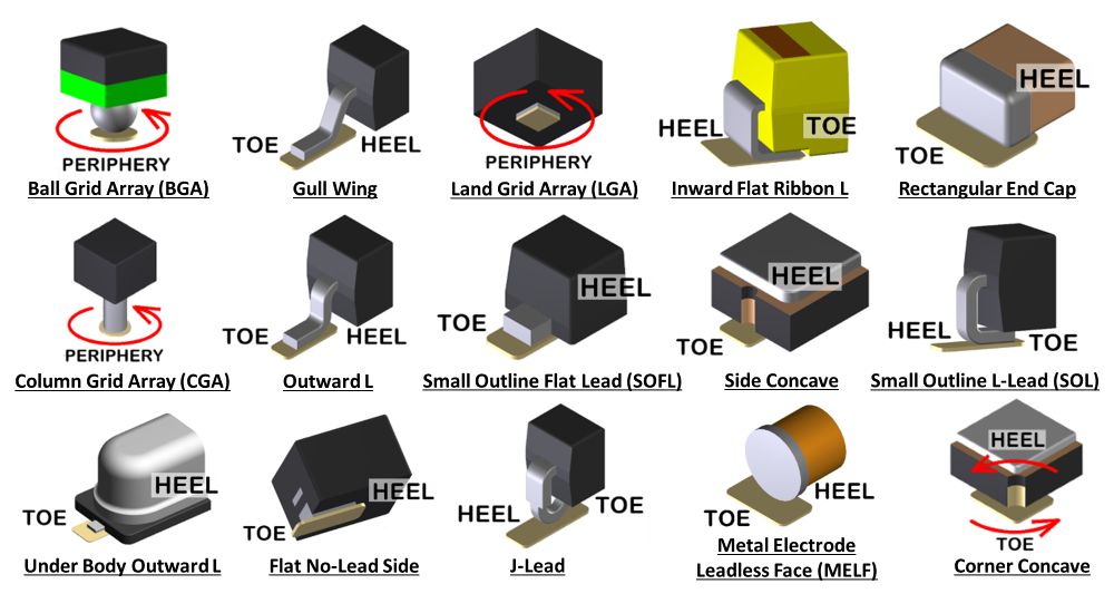

However, if the case ever occurred where you need to calculate a pattern, you need to know the terminal lead style.
You can open a component family calculator that uses one of the terminal lead styles and enter package and terminal dimensions. Then move the footprint to FP Designer to customized the pad stack pattern.
We normally start the creation of a non-standard footprint in a component family calculator and adjust the pad shape and solder mask swell prior to moving the footprint to FP Designer.
