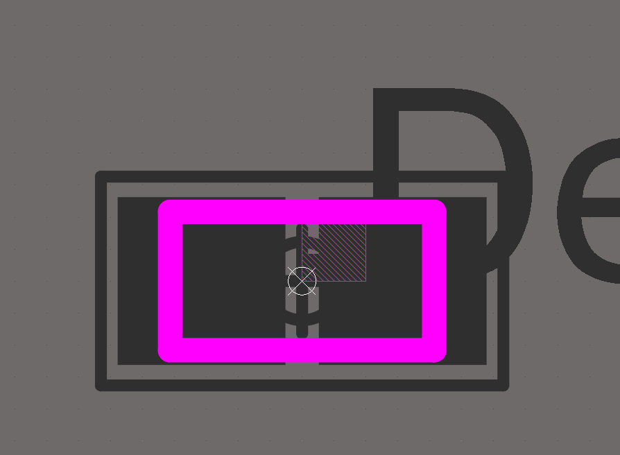

I've used FP Designer to create/export about 120 cap footprints to Altium. The Component Body Outlines have all rendered correctly but the fill hatches have not.
Any idea what I am doing wrong here?

Are you using the latest V2022.02 Footprint Expert?
Can you send us the FPX file so we can reproduce?

I am using 2021.21. Let me upgrade and try to repro on my end first. If I'm still having problems I will email you the FPX.

Upgrade fixed the problem. Thank you for suggesting that.
