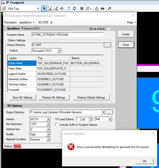

I have created a footprint with the Footprint Designer, When I export it to MG Xpedition the hkp file
is generated but I get an error message on the 3D model.
Is there a log file somewhere that might help in finding the problem?
Regards, Charles
Points: 2076
Post Options Post Options   Thanks (0) Thanks(0)   Quote Nick B Quote  Post ReplyReply Direct Link To This Post Posted: 04 Jan 2022 at 7:02am
Can you confirm you have full write permission to the location you're trying to save?
Maybe try a different location locally instead of the network?
Points: 6093
Post Options Post Options   Thanks (0) Thanks(0)   Quote Tom H Quote  Post ReplyReply Direct Link To This Post Posted: 04 Jan 2022 at 8:59am
Normally, the Footprint and 3D model folder is the same.
You're saving data to 2 different drives.
Try something different and let us know if it works.
