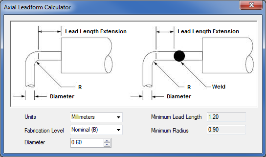

Post Options Post Options   Thanks (1) Thanks(1)   Quote Tom H Quote  Post ReplyReply Direct Link To This Post Posted: 30 Jul 2013 at 12:18pm
In the PCB Library Expert there is a drop-down menu called "Utilities".
Select the "Axial Leadform Calculator" -
