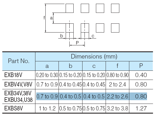

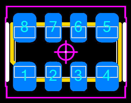

I have a question regarding a Convex Resistor Chip Array.  Library Expert is not doing anything wrong, so don't worry about that.  It looks like this:
Here is Panasonic's suggested land pattern.  They suggest a pattern that does not have extra wide pads in the corners that match the part.  They make all 8 pads the same exact size.
I've looked at other manufacturers and found a mix.  Some are more like Library Expert and some are like Panasonic.  Since Panasonic has a wide range of acceptable dimensions, I don't think it matters a lot what I choose, but I wanted to ask about the pads in the corners.  Note that the pitch is 0.8mm, and the pad for dimension A1 in the picture below is off center.  Library Expert properly creates an off-center pad (with respect to the pitch) and the pad is wider than the ones in the middle.
Do you know why Panasonic (and multiple others) wouldn't recommend a pattern with wider pads in the corners?

Here is the link to the land patterns where I got the image from:
The family I'm using is EXB38V.

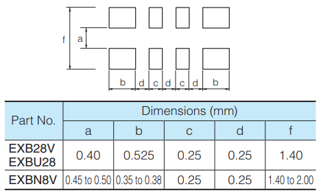

Here is the Panasonic EXB28V mfr. recommended pattern. Wide end pads for wide end leads.

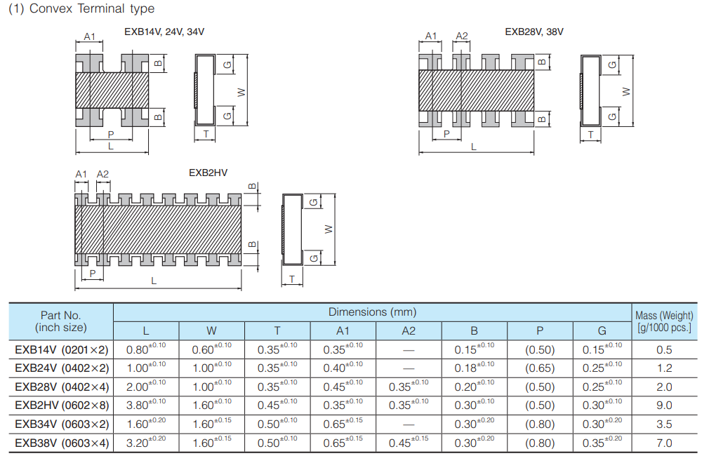

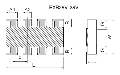

Here is the Package Dimensions. When the "A2" dimension is missing or "A1" is the same value as "A2" the End Leads are the Same Width.
When "A1 and "A2" are different values (like EXB28V), the End Leads are Wider.

Post Options Post Options   Thanks (0) Thanks(0)   Quote gcary Quote  Post ReplyReply Direct Link To This Post Posted: 13 Feb 2019 at 11:41am
I'm using the EXB38V, not the 28V.  Just to be clear, I'm not suggesting the Library Expert calculator is wrong.  I am the kind of person that wants to know "why" about everything.  Why is Panasonic's land pattern for the EXB38V not the same as the EXB28V?  Industry experts in many seminars I've attended have said that you shouldn't trust the data sheets.  Mistakes are made.  And humans write the datasheets, and humans are not perfect.  So what they write wouldn't need to be a mistake.  It could simply be wrong.  This is probably most true about layout recommendations.  In this case, I don't think Panasonic made a mistake, but there must be some rationale for the dimensions they recommend.
Maybe there is enough surface tension during reflow that the pads for the wide end leads don't need to be wide.  The part will always remain oriented properly.  This would allow a little more room for routing traces along the side of the part (I know it is a stretch, but that is all I can come up with besides they know better than IPC).  Something else I didn't bring up is the width of the pads.  Library Expert's recommended width for the inner pads is 0.54mm, and Panasonic's recommended range is 0.4 to 0.5.  At 0.54mm, a trace would need to be 3.4 mils wide to squeeze between the pads (assuming a 3.4-mil space).  At 0.5mm the trace would be about 4 mils, and at 0.4mm, the trace would be a comfortable 5.2 mils.  So maybe their recommendation takes this into account.
