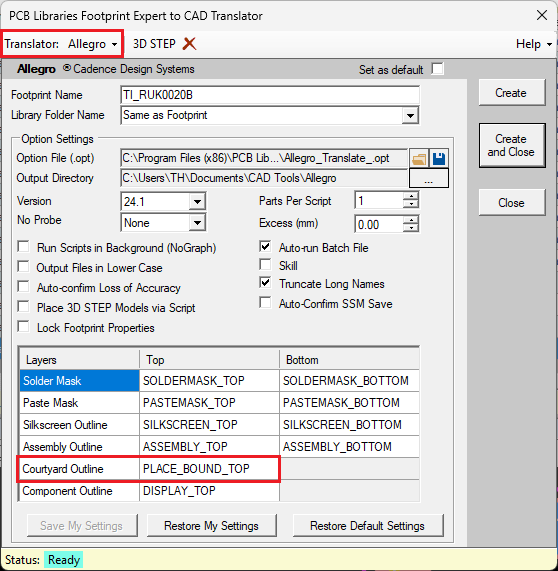

Everyone uses the Courtyard Outline for the PLACE_BOUND layer in Allegro.
Make the Courtyard Excess 0.00
Courtyard Options - Expand Courtyard to Include Silkscreen > Off
Courtyard Options - Apply Courtyard Excess Option to Pads > Ignore
The Courtyard Excess follows the Maximum Body Dimension (just like you want)
This is what other Cadence users do.

Allegro uses the Courtyard for PLACE_BOUND_TOP.

Post Options Post Options   Thanks (0) Thanks(0)   Quote Tom H Quote  Post ReplyReply Direct Link To This Post Posted: 09 Sep 2025 at 12:18pm
It's been in the Allegro translator since 2005.
