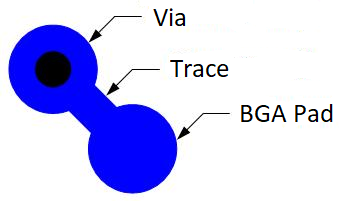

1. Once the pin pitch is 0.50 or lower, the normal dog-bone via fanout cannot be used.

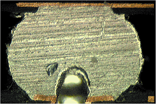

This was and is expensive. The via-in-pad must be plugged, plated over and planarized flat.
Any dimple will trap air and cause Ball Voiding.

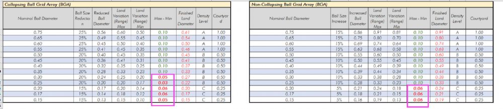

I've noticed that the Min and Max Land variation range has no pattern from 0.3mm down to 0.15mm nominal ball diameter. The values are 0.05mm, 0.03mm and 0.06mm for the collapsing BGA.
Library Expert seems to standardize it for the Non Collapsing BGA at 0.06mm for 0.20 to 0.17 nominal ball diameter.
My question is what would be the Max - Min used for nom. balls that are not in the table for collapsing BGA.
Example a 0.26mm nominal ball diameter or a 0.33mm nominal ball diameter.
Would it be OK to set the Max- Min to a single value like 0.06mm for collapsing BGA balls of 0.30mm to 0.15mm nominal ball diameter?

Non-collapsing BGA balls are intended for fine pitch parts where a normal dog-bone via fanout cannot be achieved and you must use via-in-pad technology for this trace routing solution.
Non-collapsing BGA's have larger pads to accommodate via-in-pad and establish an adequate annular ring. The BGA ball does not collapse around the edge of the pad like a collapsing ball does.
Rather, the solder mask is usually 1:1 scale of the pad size or even a solder mask defined pad to allow solder over the pad edge. This technique helps secure the pad to the prepreg.
When the pad size gets too small, the assembly might be compromised in drop tests where the solder joint does not break but the pad to prepreg becomes detached, creating an open connection and then failure.
Make your min/max land variation decision with this information.

Is the Nominal Land Diameter and Reduced Ball diameter from the above tables the same?
What will be the actual Land Diameter from the table to be used in our pad stack? Will it be the Nominal Land Diameter/Reduced Ball Diameter or the Finished Land Diameter?
I'd really appreciate your response.
Thank you very much in advanced.

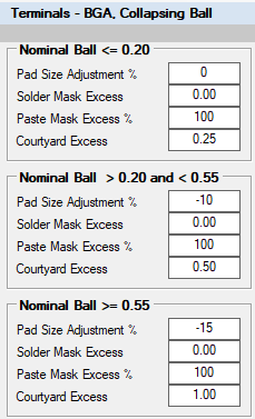

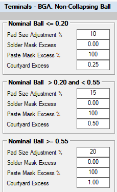

Post Options Post Options   Thanks (1) Thanks(1)   Quote Tom H Quote  Post ReplyReply Direct Link To This Post Posted: 23 Jun 2022 at 7:52am
Here is the BGA Pad Size Reduction table for Collapsing Balls:
Here is the BGA Pad Size Reduction table for Non-Collapsing Balls:
