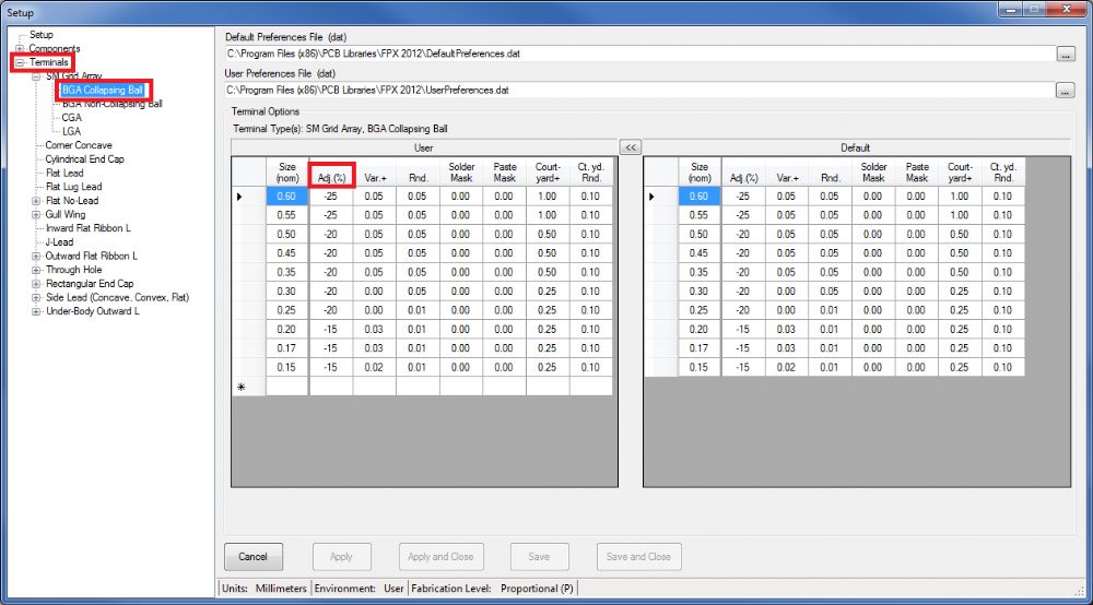

Most BGA's are Collapsing Balls. In the "PCB Footprint Expert" in "Setup > User Preferences > Terminals > BGA Collapsing Ball" you will see Ball Sizes in the first column and the "Pad Size Reduction" in the second column. The Adj% = the Pad Size Reduction from the Ball Size.
Example: the first Ball Size in the table is 0.60 mm and the Pad Size Reduction calculation is 25%. So 25% of 0.60 mm = 0.45 mm nominal.
However, IPC-7351 specifies a tolerance range of +/-0.05 mm so the tolerance range is
  • 0.40 mm Minimum Pad Size
  • 0.45 mm Nominal Pad Size
  • 0.50 mm Maximum Pad Size
The IPC-7351 standard always uses the "Maximum" material condition, so the 0.60 mm Ball Size would require a 0.50 mm Pad Size.

In fact I got to this page because I was trying to find out why the LP Wizard threw out .35 mm pads for my 0.8mm .4mm ball BGA where everyone else says Nominal would be 0.3mm.

Ok I have been playing with the software and I have a couple of questions:
My BGA is 18x18 0.8mm pitch with 0.4mm balls
1) It seems to output 0.35mm pads for all of L, N and M - does that make sense?
2) Looking at the table above there is no entry for 0.4 - I tried to add one but to no avail - does it just use the same settings for all sizes 0.35 - 0.45?
3) Did you know that text based HKP files are no longer supported by Mentor Library software? Do you have any fixes for that?
Thanks!
Points: 5788
Post Options Post Options   Thanks (0) Thanks(0)   Quote Tom H Quote  Post ReplyReply Direct Link To This Post Posted: 29 Dec 2012 at 12:33pm
The BGA "Pad Size" calculation is 1-Tier, but the Silkscreen Line Width, Ref Des Height and Local Fiducial Size are 3-Tier environment per the upcoming IPC-7351C standard.
