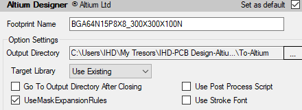

Also in the CAD translator, I see this. What is the UseMaskExpansionRules for?
I suspect I am missing something obvious.

Altium has its own Preference Rules and Solder Mask Swell is one of them.
UseMaskExpansionRules = no matter what solder mask is defined in Footprint Expert, use the Altium Preference settings.
In other CAD tools (like PADS Layout), the solder mask defined in Footprint Expert is translated directly across.

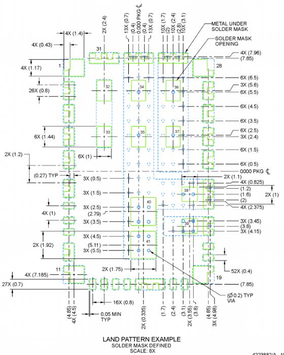

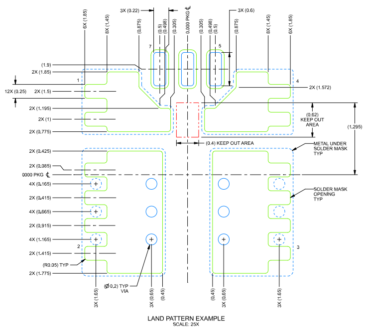

However, an example of changing times, Texas Instruments recommended solder mask swell on fine pitch and microminiature packages is 0.05 swell but in larger pin pitches and bigger packages the mfr. recommended solder mask swell is 0.07.
For BGA's TI recommends rounded corner squares for solder mask.
There are more and more semiconductors from TI that have complex solder mask shapes.
These semiconductors are becoming more mainstream every day.
