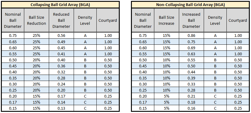

Commonly, what’s maximum diameter difference between BGA ball and ball pad on PCB can be accepted?
Post Options Post Options   Thanks (0) Thanks(0)   Quote Tom H Quote  Post ReplyReply Direct Link To This Post Posted: 14 Oct 2022 at 9:29am
Here is a BGA pad size calculation table.
