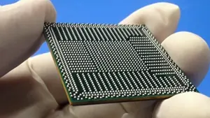

A Ball Grid Array (BGA) is a surface-mount package used for integrated circuits for CPU processors (FPGAs – Field Programable Grid Array) and memory chips (PBGA – Plastic Ball Grid Array). In this package, the terminal leads between the BGA package and the circuit board are made using small solder balls arranged in a grid pattern on the underside of the component. BGA solder balls are made of lead-free or lead-based solder, but the electronics industry is trying to eliminate lead-based solder.
A key feature of BGA packaging is a smaller footprint, with usually a smaller space to pin quantity ratio. BGA packages are more compact and allow for higher pin counts in smaller areas compared to other package types like Quad Flat Package (QFP).
BGA packages are commonly used in electronic devices like cell phones, computer mother boards, and other high-performance consumer electronics.

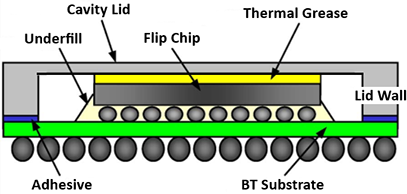

The construction of a Ball Grid Array (BGA) involves several layers and components that make up the overall package, which is used to connect an integrated circuit (IC) to a printed circuit board (PCB).
  1. Die and Chip
    • At the heart of the BGA is the semiconductor die (the actual IC chip), which is typically made of silicon.
    • The chip is fabricated and then thinned to reduce its thickness, which is crucial for minimizing the overall package height and ensuring efficient thermal dissipation.
  2. Die Attach
    • The die is attached to a substrate, often made of materials like epoxy or ceramic, which serves as the base for the BGA package.
    • This substrate provides the mechanical support for the die and facilitates electrical connections between the die and the external leads (the solder balls).
  3. Wire Bonding or Flip-Chip Bonding
    • To connect the chip's pads to the PCB, electrical connections are made. There are two common techniques:
      • Wire Bonding: Thin gold or aluminum wires are used to make connections between the chip's pads and the substrate's interconnects.
      • Flip-Chip Bonding: In this method, the die is flipped upside down, and the electrical connections are made directly between the chip and the substrate using solder bumps.
  1. Substrate
    • The substrate (also called the PCB interposer) is a crucial part of the BGA. It typically has copper traces that route the electrical signals between the chip and the solder balls.
    • The substrate often consists of multiple layers, with the upper layer being responsible for connecting to the chip, and the lower layer connecting to the PCB via the solder balls.

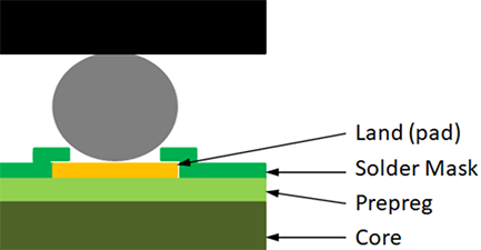

There is also a Solder Mask Defined BGA that has solder mask over the pad edges. The annular ring of the solder mask on pad is typically 0.05 mm. This technology is primarily used to secure the PCB pad to the PCB prepreg in handheld devices like cell phones. During drop tests, the solder joint between the BGA ball and the pad remains intact, but the pad could separate from the prepreg. Solder mask and prepreg are both epoxy resin (glue). The solder mask will help secure the pad to the prepreg to prevent the pad separating from the prepreg. This solder mask defined concept is primarily used on BGA pin pitches of 0.65 mm and lower, where the non-collapsing pad size is larger than the BGA ball diameter.

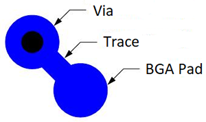

The primary reason for making the BGA pad size larger than the ball diameter is to accommodate via-in-pad technology because fine pitch BGAs cannot use the typical Dog-bone via fanout solution.
Via-in-Pad technology is a technique used in PCB design where the via is placed directly in the pad. This approach is commonly used in high-density interconnect (HDI) designs, especially for fine pitch BGAs.

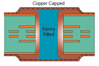

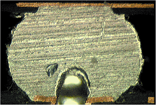

The via-in-pad (VIP) requires a separate fabrication process that includes plating, plugging and capping the hole and planarizing the capped pad to create a flat surface with no dimples. Capped pads with dimples create trapped air under the paste mask. When the PCB goes through the reflow oven, the trapped air in the pad dimple gets super-heated and blows through the solder and into the BGA ball causing a void.
Most of the time the via-in-pad is a microvia that goes from the top layer to the first signal layer. Then buried vias connect to all the other inner layers. All BGA GND connections use microvias to Layer 2. However, PCB fabrication can now drill a hole with a 10:1 aspect ratio. A 1.57 mm thick PCB can support a via hole size of 0.15 mm. But the pad size must be 0.35 to support a 0.10 mm annular ring. This solution is good for 0.50 - 0.65 mm pitch BGAs.

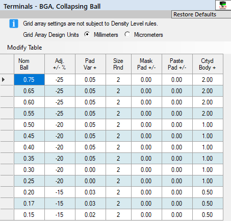

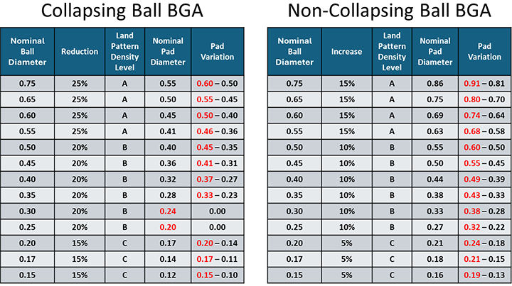

IPC-7351 provides BGA ball size tables with the reduction percentage for collapsing BGAs and the Increase for non-collapsing BGAs. IPC has a rule for BGA pad size tolerances. They take a Nominal Ball and reduce or increase the pad size by a percentage, then add a pad size tolerance (variation). IPC-7351 recommends using the Maximum Material Condition of the Variation (highlighted in Red).
Footprint Expert uses these tables for BGA footprint calculations. However, every value is fully editable by the end user. Also, you can insert additional BGA ball diameters.
Here are all the options that the Footprint Expert user can edit:
