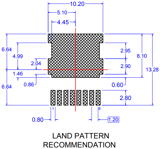

Which Template to use for these parts?

You use FP Designer to create the base land pattern for pins 1 - 8.
Pin 9 is the thermal pad and it's created as a rectangle of the outer extents.
Edit Pin 9 to add the cut-ins in your CAD tool.

OK, thanks Tom, will try it in Designer.
