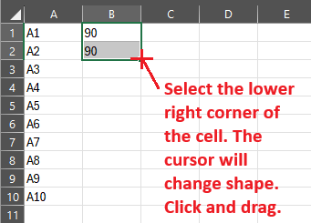

Next, add the pad rotation. Pad stacks are usually created long in the horizontal or X direction. If only one rotation is required, enter the angle in cells B1 and B2 and select both cells.
After Click and Drag, Excel will add the pin rotation

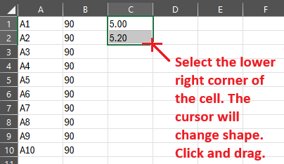

Next, enter the X coordinate in cell C1 and the step value in cell C2
After Click and Drag, Excel will add the X coordinates and step the values according to the difference between cell C1 and C2.

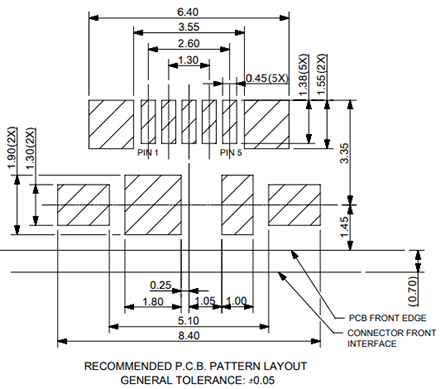

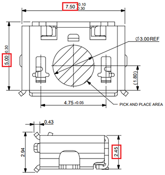

Here is a Molex Surface Mount USB Type B Connector P/N 47346-1001 Datasheet:
https://www.molex.com/pdm_docs/sd/473461001_sd.pdf
Capture 3 dimensions for Length 7.5, Width 5 and Height 2.45

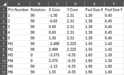

Create an Excel spreadsheet with the Mfr. Recommended Pattern X/Y coordinates and pad sizes and Rotations. The footprint Origin is in the center of the component package.
The Excel spreadsheet contains Pin Number, Pad Rotation, X & Y placement Coordinates and X & Y Surface Mount Pad Stack sizes. Using the Mfr. Recommended Pattern, it takes 5 minutes to create this. Every component manufacturer should provide this file to all their customers to automate accurate PCB footprint creation. Using Footprint Expert, this PCB library part can be created in 2 minutes and exported to 25 CAD tools.

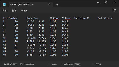

Select File > Save As > Tab Delimited (Excel) or Tab Separated (Sheets) text, and save as a .txt file. If you view the TXT file in Notepad, it will look like this:

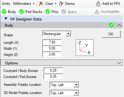

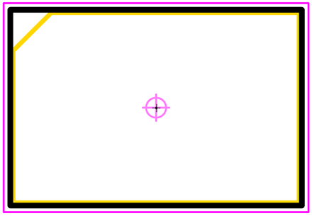

Open Footprint Expert, select "Designer" and enter the package dimensions for L, W and H.
Select OK and Footprint Expert will auto-generate the Silkscreen, Assembly, Component, Courtyard and Origin drafting outlines. Entering 3 dimensions takes less than a minute.

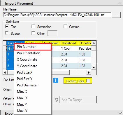

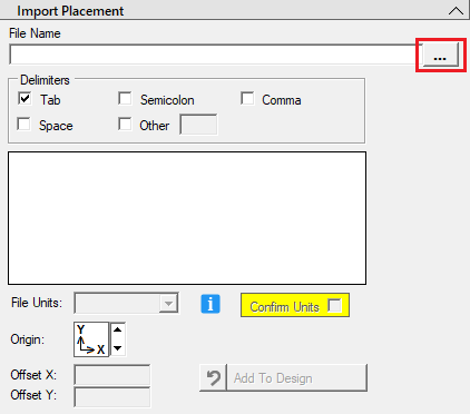

Open the Import Placement panel and search for the .txt file on your computer.

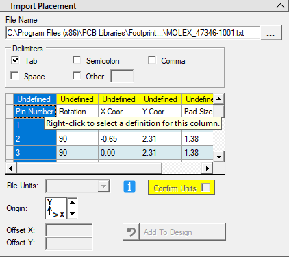

Mouse over the Yellow Highlighted Headers and a message appears "Right-click to select a definition for this column".
Select the proper function for each column from the pop-up list.

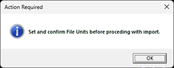

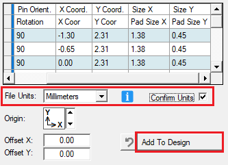

Do this for each column and then select and Confirm Units.
Select Units, Confirm Units and Add to Design

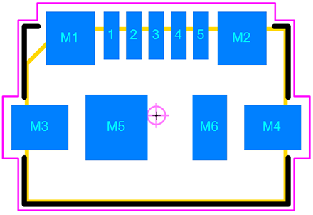

Here is the footprint with the proper pad stack location, size and rotation for 5 different pad stacks.
The Silkscreen Outline is auto-trimmed per your personal Option settings, the Assembly Outline has a Pin 1 Polarity Chamfer and the Placement Courtyard auto-sized and contoured around pads.
