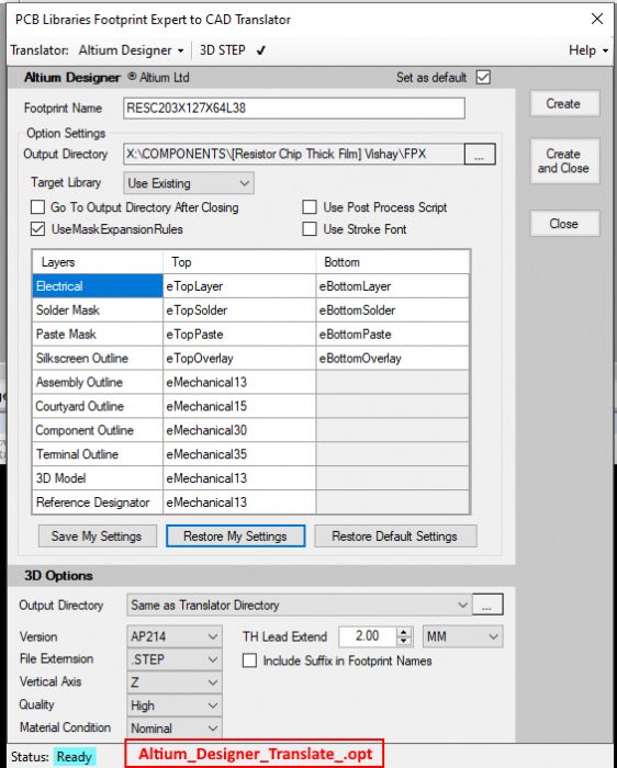

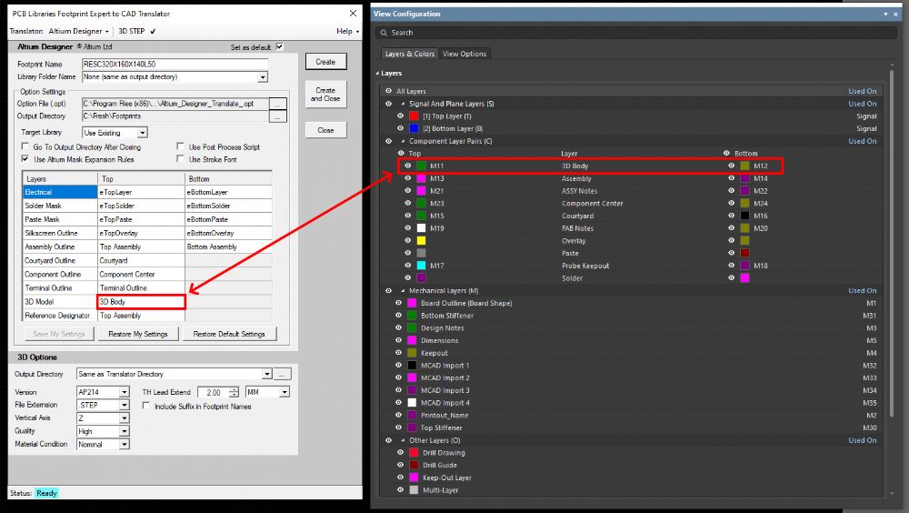

I cannot figure out what I am doing wrong here and need some help, please. I am trying to configure FP Expert CAD ME layer assignments (left) to match the Altium PCB Layerset shown (right).

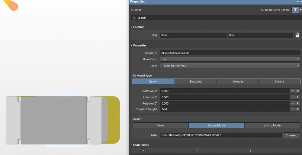

My question applies to several different layers here but I'll just use 3D Body as the example for this question. Rather than configure FP Expert to explicitly specify Mechanical 11 here, I would like to specify "3D Body" so that it doesn't matter what the underlying mechanical layer is, which will be dependent on which client workspace I am working in. When I try to do this as shown, and run the script to generate the footprint in a new Altium PcbLib, the 3D Body is "there" but greyed out, as shown.
If I then Press 3 to turn on 3D view, the 3D body shows up in 3D view. If I then click on it, Properties is saying "Layer not defined".
What am I doing wrong here? Is it possible (I hope!) to assign the layers using the Altium Layer Name instead of eMechanicalXX?

Post Options Post Options   Thanks (0) Thanks(0)   Quote Tom H Quote  Post ReplyReply Direct Link To This Post Posted: 22 Mar 2024 at 1:51pm
In the Altium Translator menu, the mechanical layer number must be changed.
The word "eMechanical" cannot change or be renamed or you will break the script language.
You can change the Numbers, but not the text

OK, thanks. I was hoping I could leverage the Component Layer Pair Names Altium has so that it can redirect to the specific mechanical layer based on the active mechanical layerset. As it is right now, I've got 5 different FP Expert installations on my machine, each one dedicated to a specific client and any footprints I make are only compatible with that client's workspace.
I'm trying to get to a workflow solution wherein this is not necessary and any footprint I create is compatible with any Altium workspace. Maybe there's another way to do this. I don't know.

I understand that layer sets are defined in Altium and not in FP Expert.
What Altium does provide is a layer abstraction mechanism that allows layers to be referenced by these "names" instead of eMechanicalXX. So it seems like it should be possible for the scripts to specify the abstracted name instead, even if not presently implemented. Perhaps this abstraction layer is not exposed to the scripting language. I don't know.

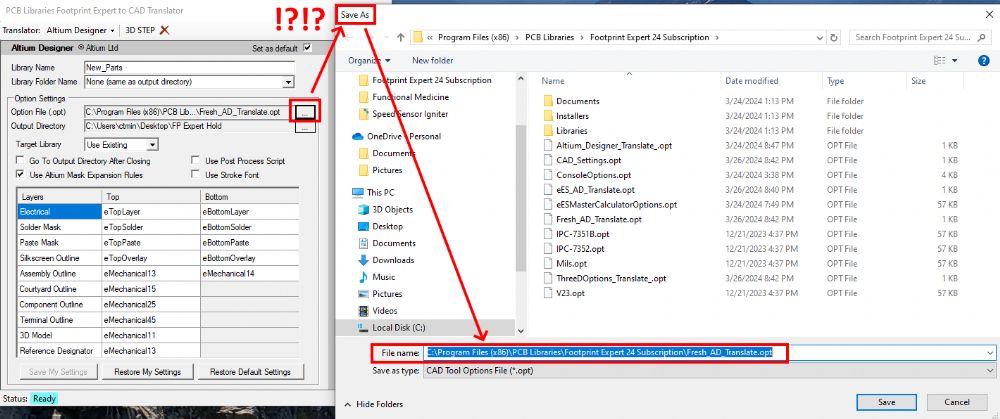

The translator window does not specify which options file is being used. This is a risk when generating multiple sets of outputs as I don't know which settings are being applied. I would be clearer, and less prone to unintentional user error, if the GUI displayed the filename somewhere, like here.
Also with no File Open option, and just Save/Restore/Restore Default, it's not clear to me how I would even specify a custom filename for these.

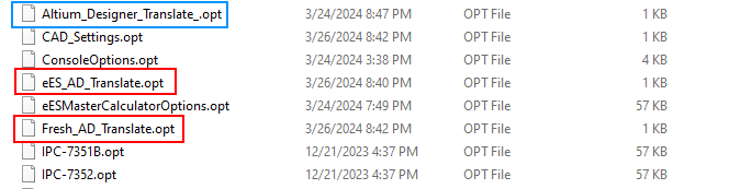

I'm getting around to next steps here and I can't figure out how to actually select a different options file.
For starters, I now have created two different options sets (in addition to the default) I want to swap between, as shown.
Now, when I go to click on the ellipses for the options filee path/name dropdown it takes me to a "Save As" window and asks me to confirm overwriting that file. That's not what I want to do.
I am unable to find anything in the PDF documentation that explains this.
