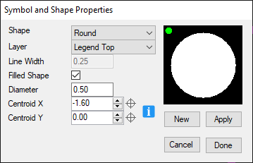

Here is the new V2020 "Insert Shape" dialog menu -
You see the up/down buttons to the left of the coordinates. They are used to move the polarity marker to your desired location.
The layers have been expanded to Top and Bottom Legend, Assembly, Solder & Paste Mask.
You can stay in the menu and add multiple drafting symbols.
