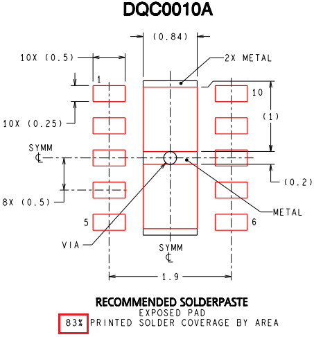

However, Some manufacturer's like Texas Instruments still reduce the paste mask on thermal pads less than 1.00 mm width.
In this example, the paste mask apertures are 0.84 (same as the pad width) X 1.00 mm with a 0.20 mm gap. 83% paste coverage.
I recommend that if the mfr. provides this type of detail, you should probably use it.
