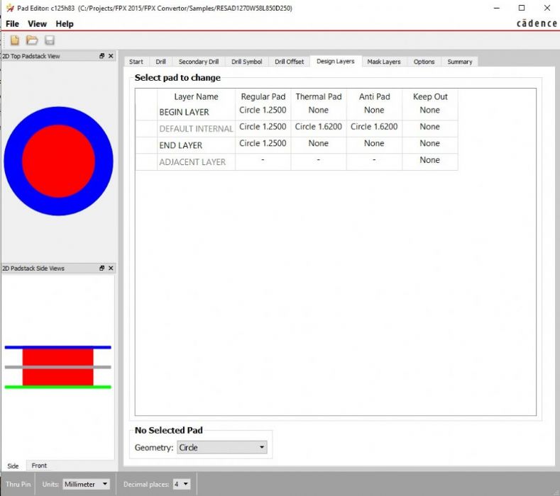

Out of curiousity.. do you still have 16.6 loaded? 16.6 uses pad_designer, whereas 17.2 uses the new padstack_editor. I've had issues with 16.6 also being on my machine when trying to run 17.2. Make sure you use the Cadence Switch Release program to set the release to 17.2.
As a check, I just ran thru-hole reference parts with both square and circle pads without issue, and they mirror what you have above, so I don't think its a problem with the script. I think its getting its wires crossed trying to run the 17.2 programs. Here is what the new padstack_editor looks like:
