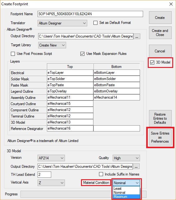

Altium displays the components with maximum dimensions of the body created by Library Expert Lite 2015, but Library Expert Lite 2016 and LE Pro 2016 only display nominal dimensions for 2D and 3D Model.
Therefore, is it possible to export the 2D & 3D model with the maximum dimensions of the body using Libray Expert Pro 2016?

You can output 3D STEP models in Minimum, Nominal and Maximum material condition.
In the Build Part or Library UI in the lower right corner, make your selection and Save As Preference.
